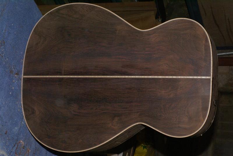

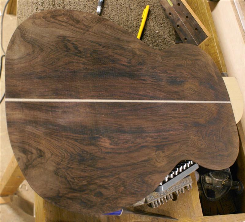

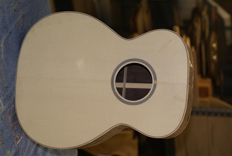

Here are some pics of the pile of wood I posted earlier. It is a Brazilian Rosewood OM with an european spruce top. The bindings and butt wedge are figured maple with a bwb. I did not mitre my purflings, I tired at first but then I screwed up when I was chiseling the mitres so I just butt jointed the whole thing. I could use everyones advice on that operation. Anyway thanks for looking.
Pile of wood
Guitar coming together
Now to scrape, scrape, scrape. Probably one of my favorite operations. Then sand, sand, sand. One of my least favorite operations. Unfortunately wood working is about 50% sanding.
Thanks again guys and gals,
Homeboy

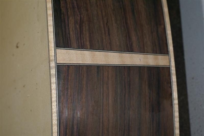

Nice shape and great wood combinations - it will sound great I'm sure. The purfling at the butt-wedge looks neat enough to me.

I'll echo the comments on the wedge, looks very clean and nice to my crooked eyes!

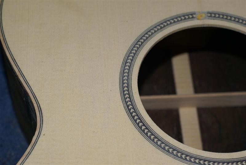

Nice work, Home! I'm likin' that tall-and-thin brace visible through the soundhole. Did you brace the top that way, too?
PostPosted: Fri Oct 06, 2006 5:55 am
Posts: 194
Thanks for all of the positive comments. I appreciate it and it keeps me building. The braces are all tall and thin. I was at the Somogyi guitar listening session at the GAL and he talked a lot about the strength increases with height opposed to width of braces. He made a lot of sense so I am going with it on my builds right now. I'll let you all know how it sounds pretty soon. I'll be finishing two next week.

   Post a few pics of your process for inlaying that herringbone rosette.
Kevin Gallagher/Omega Guitars
PostPosted: Sat Oct 07, 2006 7:31 am
[QUOTE=Kevin Gallagher]    Post a few pics of your process for inlaying that herringbone rosette.
Indeed! Very clean-looking work.
PostPosted: Sun Oct 08, 2006 2:36 am
Posts: 194
The Rosette was a pre-made job by Stew-Mac. I wish I could say it was all my work but I can't. I bought the thing in a three ring rosette but just used the center ring. I cut all of my rosettes with a Milwaukee router and a circle cutting jig on the base of the router. I used to use the dremel but it wobbled too much for me.
